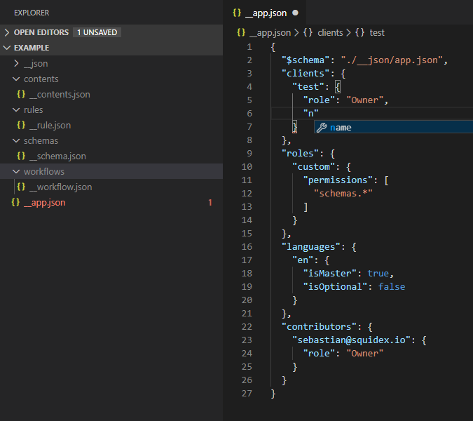

The `sync` command can be used to create a new folder with sample files that can then be imported to the App.
The following command does the same (replace `<folder>` with a folder name of your choice):
```bash
.\sq.exe sync new <folder>
The CLI creates a set of sample configuration files that begin with \_\_ (see screenshot below). The files starting with a double underscore are ignored during the synchronization. Therefore, you have to rename or copy the samples files in order to sync them.
The screenshot below shows a typical folder structure with sample configuration files:
<div align="left"><figure><img src="https://2730255609-files.gitbook.io/~/files/v0/b/gitbook-x-prod.appspot.com/o/spaces%2F-LrL94QfeasZ0wF6YAvB%2Fuploads%2F80QklBf1wYV4msT5wC8e%2F2023-03-02_20-00.png?alt=media&amp;token=f887edee-ae52-4290-92cd-b4ac3b9dd152" alt=""><figcaption></figcaption></figure></div>
The CLI also generates JSON schema files that are referenced by the configuration files and provide basic intelligence features in editors such as [Visual Studio Code](https://code.visualstudio.com). You will see error messages when you do not follow the JSON schema. Do also look out for additional errors that might occur when synchronizing your configuration.
